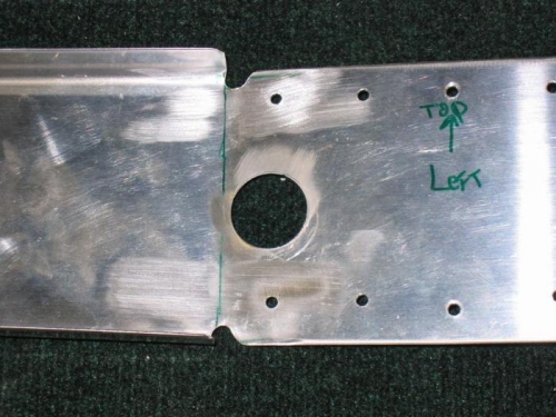

Brief Description:  Oversized cable hole Left HS-702
I oversized the cable hole in the Left HS702. HS702 is the front Horz spar. The bit slipped. I used the wrong tool. It is supposed to be 5/8" and centered. It is 7/8" and slightly off centered. I called Vans aircraft and they said that it needed to be replaced. Oh well.... another HS-702 is on the way.
