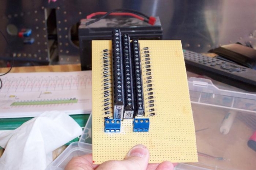

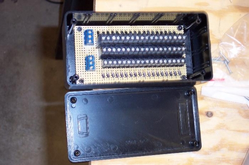

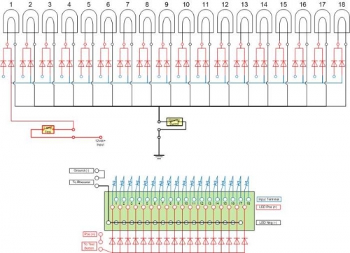

I built the terminal box that will tie in the systems and the LED lights to the annuciator strip. Took a while on visio to figure our what I needed and to design a system that can test and dim the lights without affecting the systems tied into them. I think it turned out pretty well. Tomorrow I will mount the box on the light bar.
Visio schematic for the circuit
Board is built
Board is built
Trimed and Installed in a box
