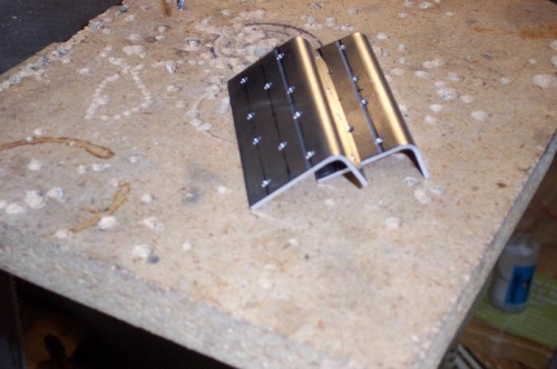

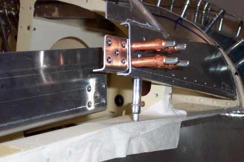

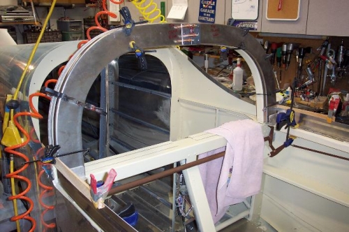

Over the last few days I have spen time fitting up the canopy frame and making sure everything is properly aligned. I made the 613 splice plates and fit them in place along the side rails. Match drilled/dimpled and riveted them in place. The shims where not a big deal, just took time to make them right. I also drilled the top splice plate thus everything is clecoed together. I did start working on the frame stiffeners. Lots of bending and tweaking.
splice plate ready for riveting.
frame still clamped in place after drillling
