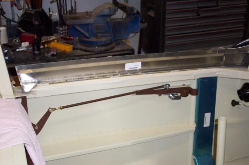

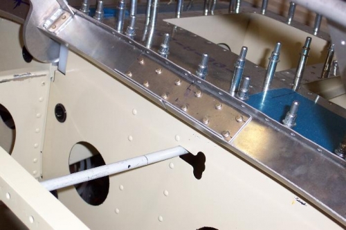

Canopy frame fitup work continues. Riveted the front frame splice plate together. Laid out the side rails to see how they fit. Made up the rear frame splice place and drilled it to one half of the frame per the instructions. I also maid a drilling template so that I can drill the 2nd half of the frame splice plate while the assembly is in place.
Riveted the front splice plate
Side rails set in place
