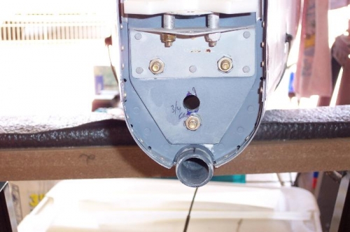

Brief Description:  Fuse assembly - 103 - Rudder misc
In was not happy with the rudder pedals friction so I worked on the center support block and added a backplate to spread out the compression load on the block evenly. Much better! I also finished drilling the mounting holes for the vert stab to the fuse rear. I also match drilled the center support bracket to the vert stab.
Center support block with backplate
All holes drilled in vert stab, 3 for the tailspring support, the center hole is for the rudder lights
