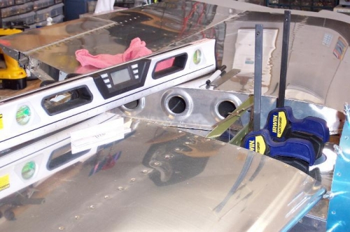

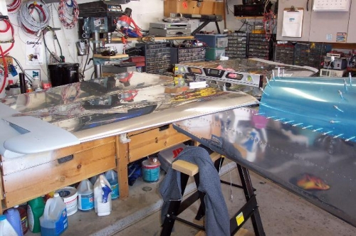

Installed the horzontal stabilizer today. Took my time and rechecked all parameters to ensure that the stab is straight and square with 0 deg incidence. The drawing call for 3/16" shim to get the zero incidence. I ended up using 1/4" to get the incidence as close to zero as possible.
Verifing stab is level
Verifing zero incidence
Verifing fuse is level
