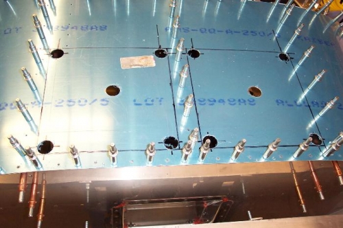

I decided to installed access hatches in the forward fuse. This should help in reducing the amount of time I need to be laying underneath the dash! :)
Laid out the hatches

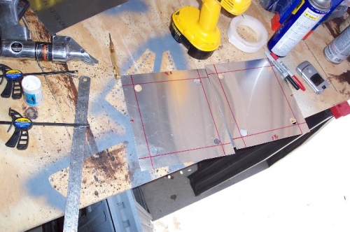

Cut the backup plate
Match drilling the backup plate to the skin using a rivet fan
