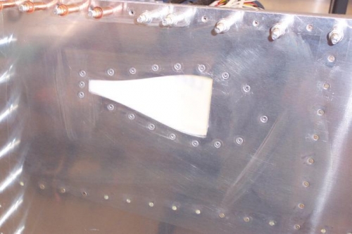

Brief Description:  Fuse assembly - 80 - side air vents

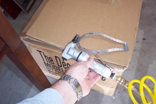

Installed the side air vents. I deviated from plans and made a continous metal backing ring to support the intake instead of the little metal tabs that vans recommends. RIveted the assembly to the wall and I also used JB weld to seal the joint. It sands and cleans up much nicer than proseal and should perform just as well. This took a little more time, but it turned out nice.
Made a mess using my nibbler to cut out the backing ring
outside view
outside view
Inside view
Inside view
