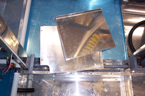

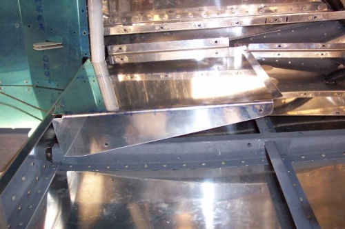

Brief Description:  Fuse assembly - 64 - More flap work and covers
Worked on the flap actuator bearing blocks, ensured that when bolted down the resistance was not too heavy. I ran the flaps up and down, the motor pulls about 1 amp up and down. I tried to put resistance on the linkage to simulate flap actuation and the current never exceeded 1.5 amps. Nice.
Worked on the side covers in the baggage area. drilling, dimpling and riveting on the nutplates.
