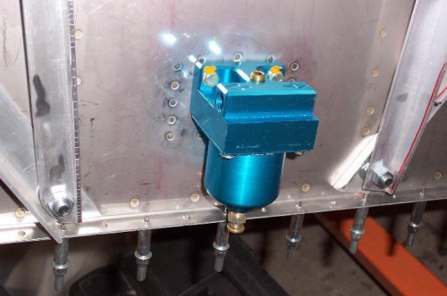

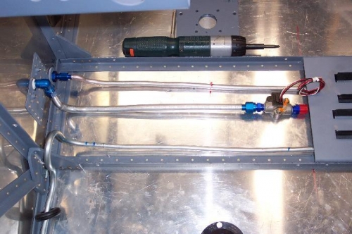

Long but productive day. Installed the gascolator on the firewall after riveting on the doubler. Installed fittings on the selector valve. Installed the fuel injection return line and fittings. Installed the fuel flow transducer and plumbed it to the gascolator inlet. 1258 hours to date.
Gascolator installed on the firewall.
Note the Fuel return and feed lines.  Note the Fuel flow transducer

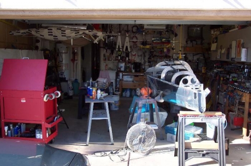

Garage sprawl.  It all stows on the weekend to allow the Wifes car access.
