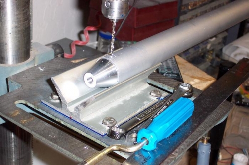

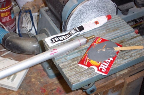

Brief Description:  Fuse assembly - 35 - Control Column and forward el
Cut both elevator pushrods to length. JB welded the end fittings in place. Drilled and riveted the end fittings per the plans. Primed everything. Installed the control column and the forward elev pushrod. Bolted it in place including the middle bellcrank assembly.
