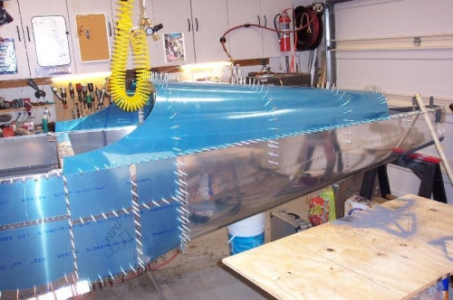

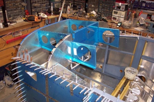

Brief Description:  Fuse assembly - 24 - Misc prep work
Installed upper fuse pieces so I could drill the forward angle supports to the longeron. Dimpled both rear skins and cleco'd them to the fuse. This will keep the fuse straight when I roll it on the side next week and rivet the bottom rivets. I had purchased about 200 extra 3/32 clecos on top of the 400 that I already had. I am currently using 592 of the 600. :)
There is 1074.8 hours on the project to date.
Rear skins in place
Rear skins in place
