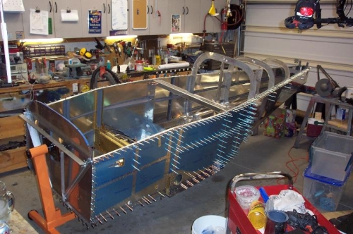

Brief Description:  Fuse assembly - 21 - forward structural
Finished riveting the lower sections that were accessable while the fuse was upside down and the forward bottom skin was removed. Cleco'd the forward bottom skin in place. Glad I have a Butt load of 3/32 clecos. :) Rotated the fuse upright. Very Cool feeling! I have a Canoe!
The engine stand is too short to rotate the fuse 360 deg
