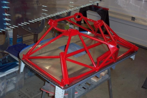

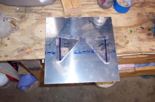

Received a piece of 0.063 plate from vans and recut the 684 corner brackets. The ones from vans are too close on edge tolerances. After finishing the bracket construction I removed the firewall and match drilled my new engine mount while it was convienent. I then removed the left side skin and finished dimping all remaining holes since everthing is match drilled at this time.
Old brackets on plate stock
new powder coated engine mount.
