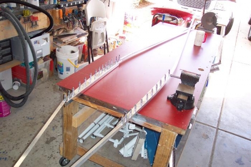

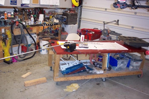

I understand now why people hate this step. It does suck. Bending two 15' long angle stock to a template was very time consuming and teadous. It took all day but came out very nice. Basically you need to shape this angle stock to a very gradual curve. It needs to be done within 1/32" variation along the curve.
Bending in progress
Bending in progress

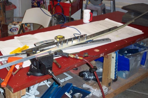

Drilling the 721 stiffener to the longeron.
All done.
All done.
