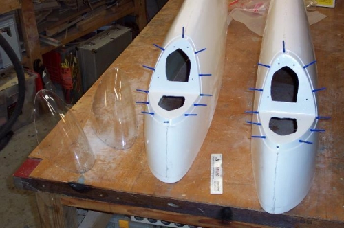

Cut and mount wing tip lenses
Cut the wing tip lenses to shape. Very time consuming to make them just right. Fit the lenses and then drilled the mounting holes. Installed the click bond nutplates with epoxy and set aside to cure. 540 hours on project to date.
Lens trimmed and fit
Nut plates installed and curing
