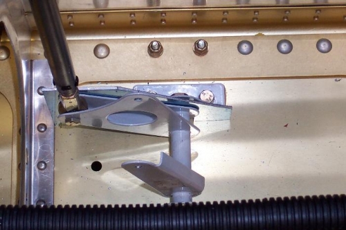

Alignment jig holds aileron in place while the aile position is checked.

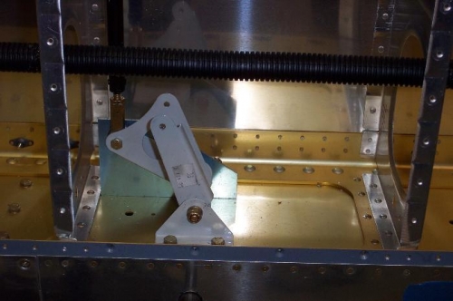

You then adjust the pushrod length for proper alignment.

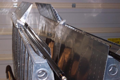

Both ailerons installed and ready for the large pushrod installation.
