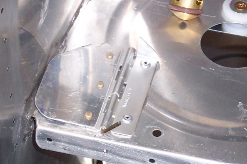

Brief Description:  Installed right wing tank baffle
Installed the flappers in the inboard bays to prevent rapid fuel sloshing during manuvers. It keeps the fuel draw constant during rolls. Riveted the rear baffle plate on the right wing. Big job. One down, one to go.
Installed Flapper
Installed Flapper

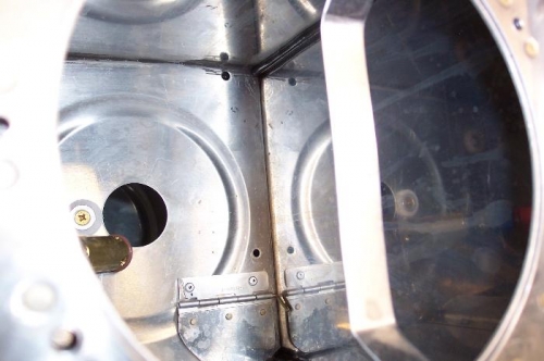

Rear baffle on right wing done
Inside view afterwards
