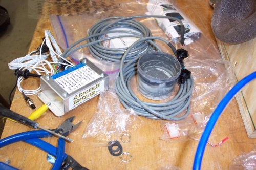

Brief Description:  Installed AE fuel guardian probe and riveted two m
The other day I received the AE fuel guardian system. It is a optical sensor that provides an indication when the probe no longer is wetted by the fuel in the tank. I set up the probe so that it will alarm when there is about 1" of fuel above the fuel pickup in each tank. I will measure the exact quanity later during construction. I also riveted two more ribs.
Testing the system in a cup of water

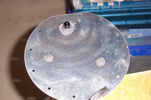

The probe is installed and sealed in place.

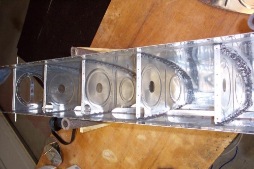

four ribs out of seven are done in each tank.
