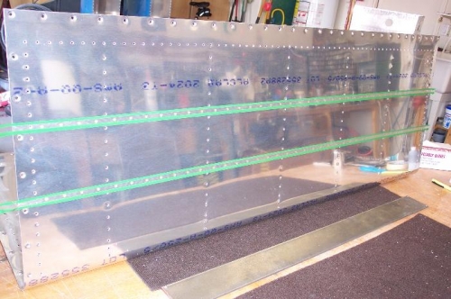

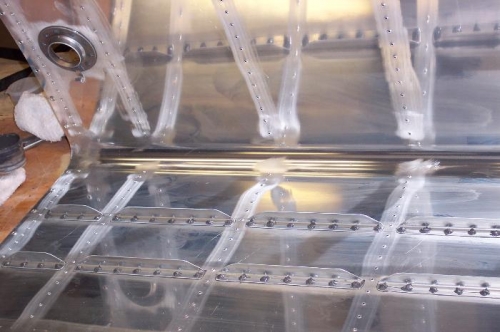

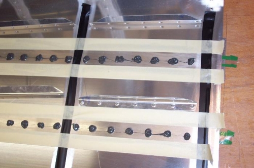

Riveted the stiffeners and drain fitting on the other tank. Installed the fill neck fitting on both tanks. Used about 6 oz of sealant yesterday and about 7 oz today. Need more MEK and Acetone. Going thru a lot of that stuff during the cleanup (including latex gloves). Got everything done early trying to beat the heat. It is supposed to be 110 again today and I do not want to do this stuff with the garage closed up and the AC on.
Rivet tape holding the rivets in place
Dabbing the sealant in place
