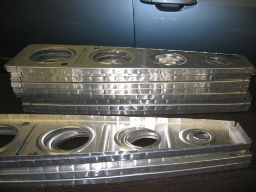

Started fluting the ribs to straighten them out. Got through about 1/2 of them. Big difference after fluting. This work is hard on the hands. 262 hours to date.

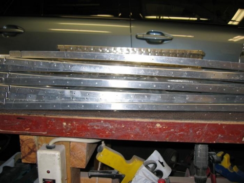

Ribs raw from Vans, warped from the press process.
Nice and straight ribs after fluting.
