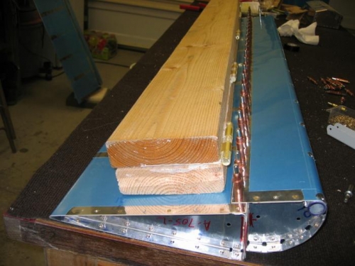

Finished the Ailerons today. A while back I bought a custom bucking bar. It worked perfectly for bucking the top skin rivets. I wrapped it with electrical tape to protect the adjacent surfaces. 205 hours to date.
Taped my custom bucking bar to a pvc pipe and it worked well.  I was able to buck the rivets by myself
Keeping the Aileorn straight while I finish the riveting.

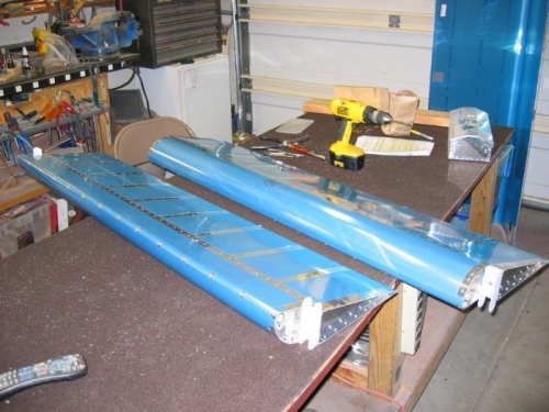

Done!  They look good.
