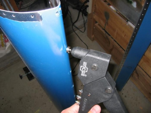

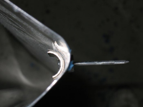

Brief Description:  Dimpled the Aileron leading edge

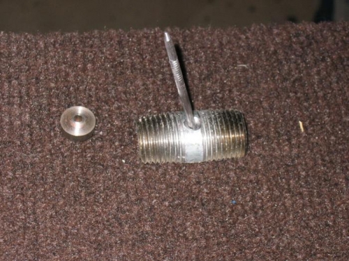

I did not like the vans technique to allow the pop rivet dimple the skin into the pipe counter weight. I fabricated a female dimple die from a pipe nipple to form to the round leading edge. Worked pretty good!
