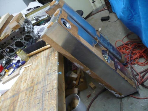

Clean out tanks and re-cork
Used water to purge chips from tank. The finger screen was clear but they used the same glue on the fittings, 11/16 wrench and steady pressure got em out. Wire wheeled them and will use fuel lube to put em back in.

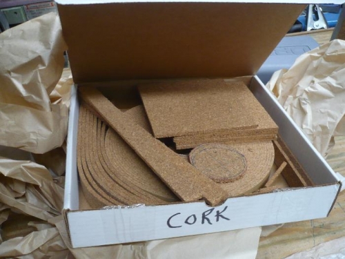

Re corked areas most in need.

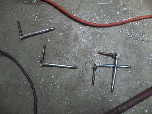

Made alignment tools for wing bolts
Alignment tools
