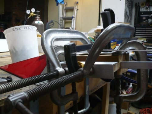

Arrange clamps and 1/8" x 1.5" x 1.5" alum 6061-T6 angle to provide strength.

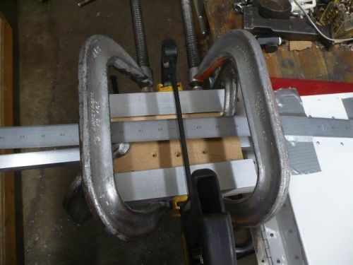

Center clamp first, then large C-Clamps, then small C-Clamps to hold the walls together.
Tighten large clamps a little at a time and keep snug the center clamp. Keep a lookout for miss alignment.

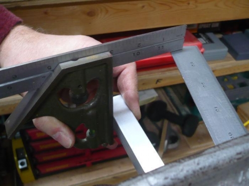

Check distance, I want 2.5" so I added .5 for springback to move the end 3" before releasing the clamps.
Tighten slowly
Check if going straight
Little by little, tighten clamps
