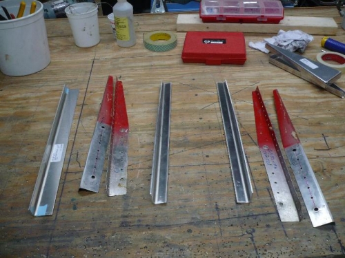

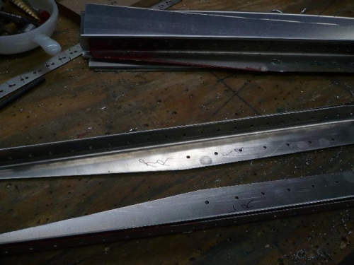

The CZAW had .040 thick center spar uprights. These are replaced with .060 ones with this upgrade.
Put joggles in rear uprights with 1 ton arbor press and some hardwood.

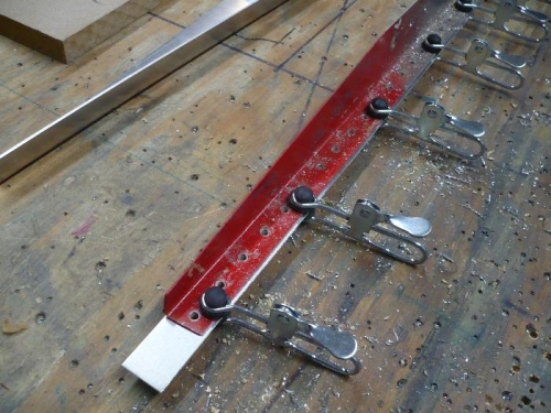

Made duplicating strip from some ,030 alum for each set of holes and transfered locations and end trim to the new parts.
Only did the rear parts, leaving the fronts for at the hangar.
Duplicating strip
New rear uprights
