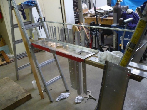

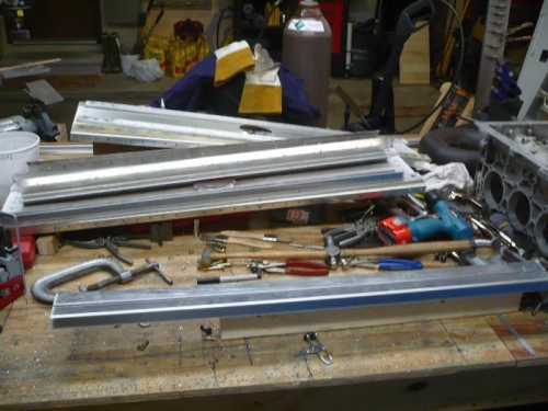

Final assembly and prep for primer
Transfered new upright holes from other side to this side. Opened holes up slowly on drill press and reamed the last little bit.
Disassembled, Deburred and cleaned up areas that get primer.

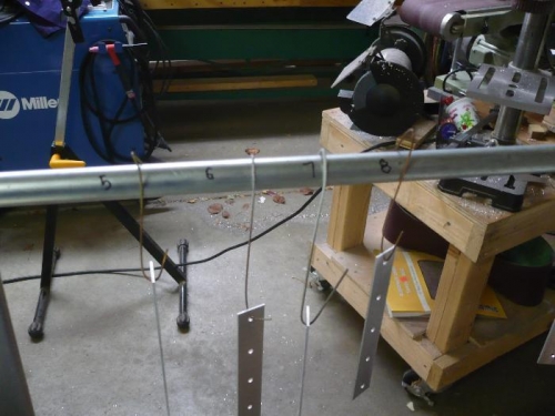

Numbered the hanging places because the markings on the parts get removed during cleaning.
