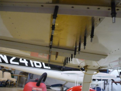

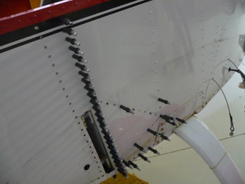

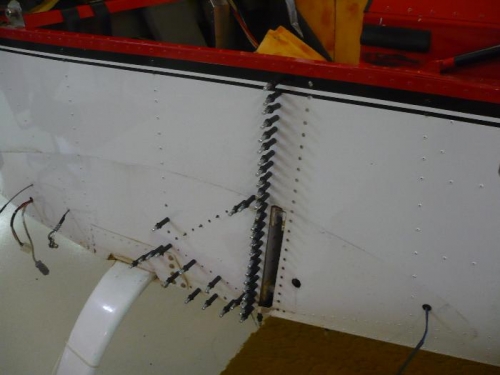

Marked rivet holes in rear verticle and forward center spar uprights. Reamed bolt holes.
Cleared binding material away from the corner joint of rear uprights so they can sandwich properly.
Laid out forward rivet line on bottom doubler.
