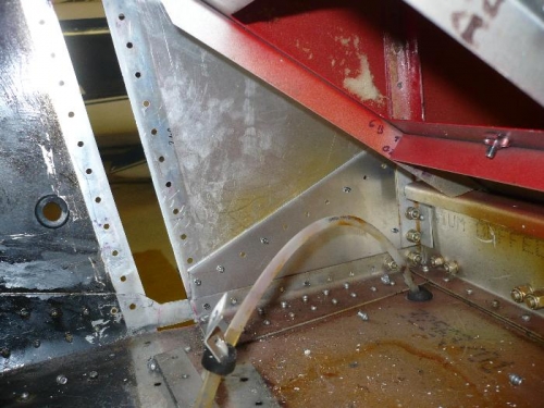

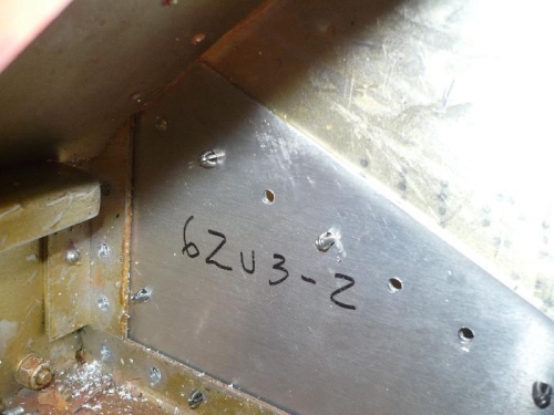

Brief Description:  Place the doublers between
The verticle spar piece sandwiches between this piece and the existing doubler at the floor side wall junction. Marked the rivet lines on 6ZU3-1 then tapped it into place, used flat blade screwdriver from below to coax the steel gear leg bracket open a little so this would fit in. Lined up the lines, drilled, clecoed and bolted back together. Had to get AN5 bolts because the AN4's wern't long enough.
see lines on 6zu3-2?

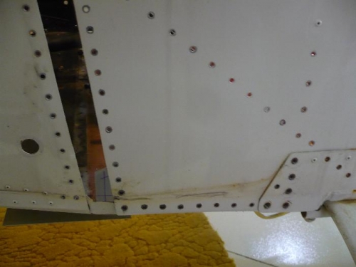

right side inside
right side inside
Looking back from the inside
