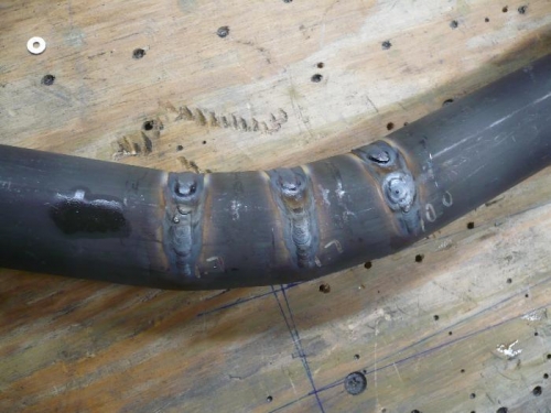

Weld Main Tube
Had to cut 4 of the tacks and remove .06 from the cuts to get the correct angles to come in. Tacks should be made to pull the tube back to straightness before final welding is done.

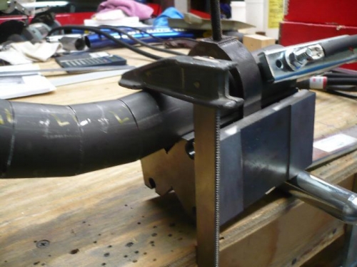

Another view of the setup

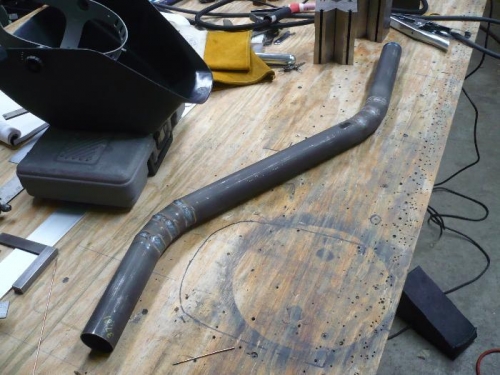

Ready to clean up
Lays right on the layout.
