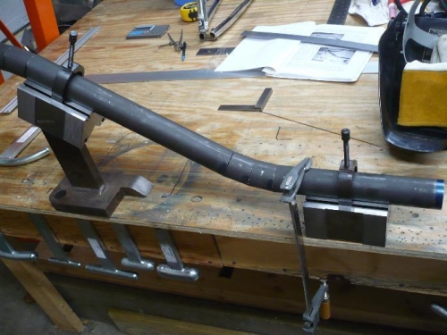

Made layout right on the table of the main tube.
Positioned the tube in the vee blocks so they would be in the correct orentiation for tacking the tube back together.

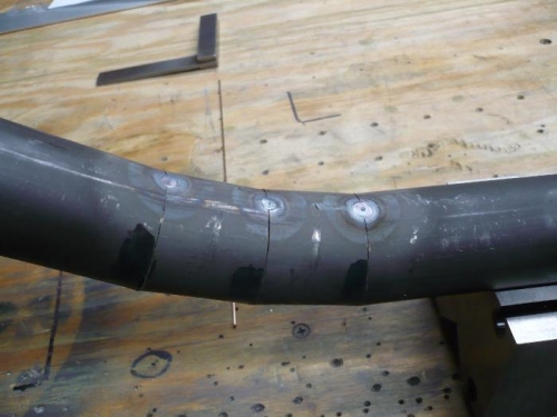

Clamped to close the gap to zero.
Tacked

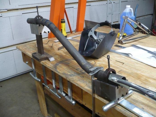

Setup for other end
