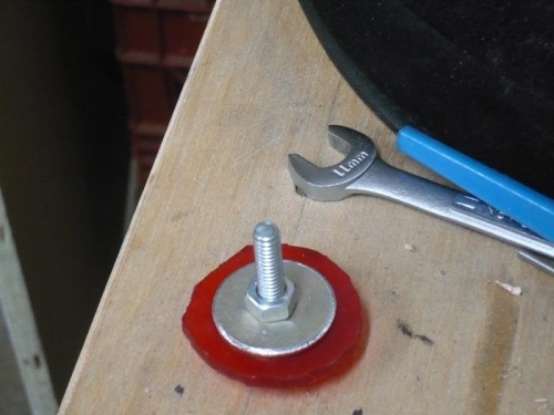

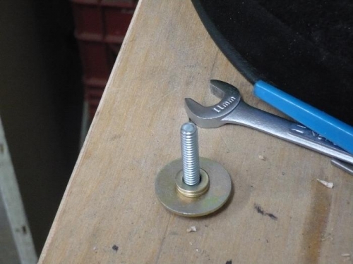

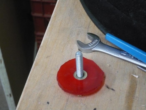

The Red 1 5/8" washers are going to get a bevel on the outside 1/4". Made an arbor using two AN960-416 washers on top of a 1 1/8 flat washer on a 1/4" dia bolt, placed red washer on top then closed it up to turn it on the drill press.
Arbor
Red washer is piloted
Read to turn
