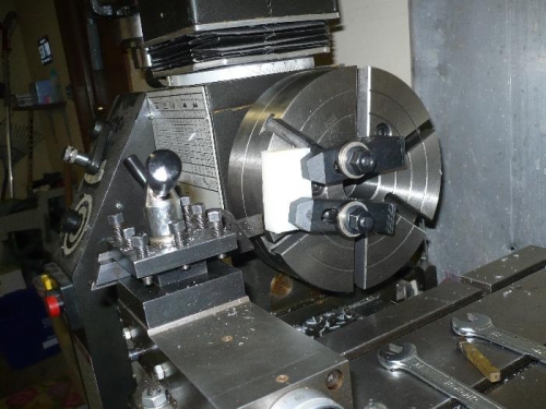

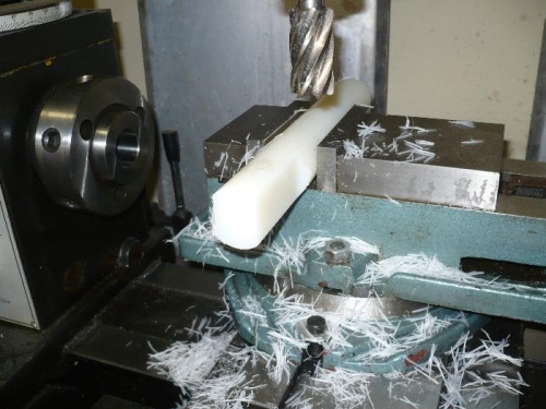

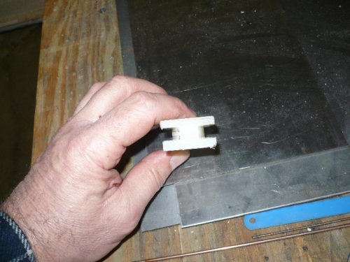

Had some 1.5" dia nylon round stock so I carved a rectangle out of it to get started. Then the rectangle was setup on the face plate to cut the large tracking radius. I had enough material so I did both sides and split em on the band saw at the end to make two parts.
Roughing out the rectangle
Plunge cutting the groove
Two grooves
Two grooves
