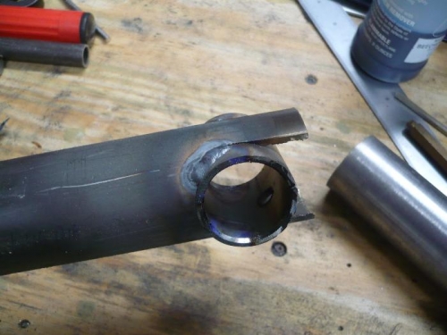

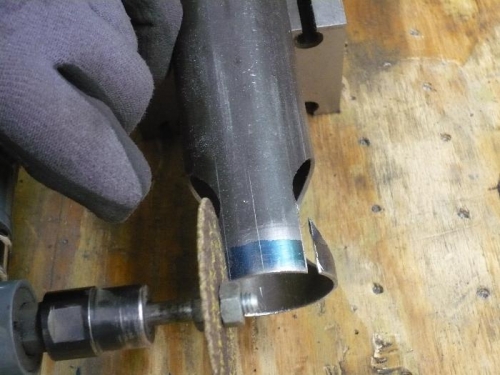

Layout and cut end for rear suspension pivot. Removed the bronze bushings from the pivot before welding. Clamped pivot in place and tack welded in place. Add some weld before forming the ends. Using heat, form ends around the pivot. Tack ends and hammer down the tacks before they cool to get a nice fit.
