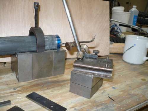

Brief Description:  Layout and cut Main Frame Tube
After the layout of the cut lines mark where the cuts stop, .25" up from the outside of the tube.

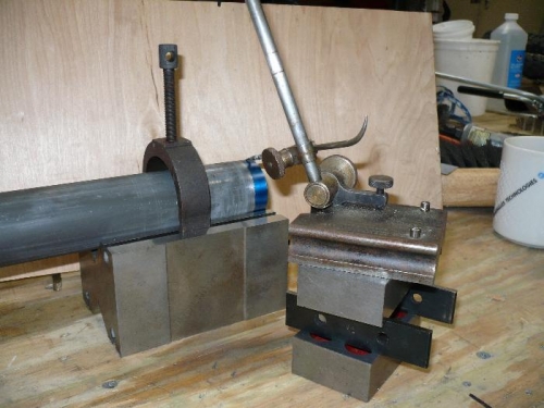

Image 2) Set surface gage to top of tube while it is sitting on top of 7/8" risers (black bars), remove the 7/8" and scribe the center line to be able to reorient the tube if necessary.
Mark end of cuts up from bottom.
Setup for center line

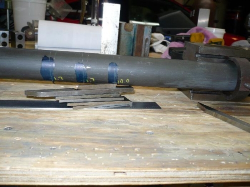

Scribe center line
Scribe center line
