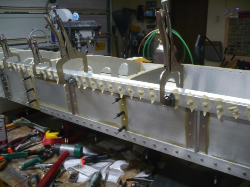

Brief Description:  Position new spar angle and drill
Clamped new spar angle in place and transfer punched centers. Removed and pilot drilled spar angle on drill press. Repositioned and clamped back in place and opened the holes up for the AN6 rivets and one AN3 bolt.
Deburred all and re-assemble for riveting.
