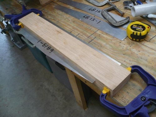

bending flange on hardwood 2 of 6

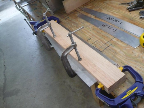

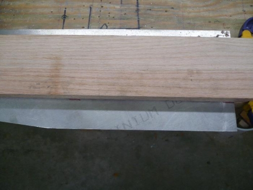

Line up the lines, clamp to flip, flip, remove clamps and gently slide entire setup back to the edge of table over a leg.
Line up bend lines to edge
Clamp to hold part
Scooch it back
