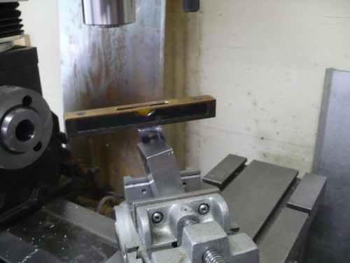

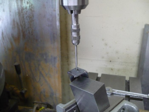

Put brackets in position and transfered holes from firewall.

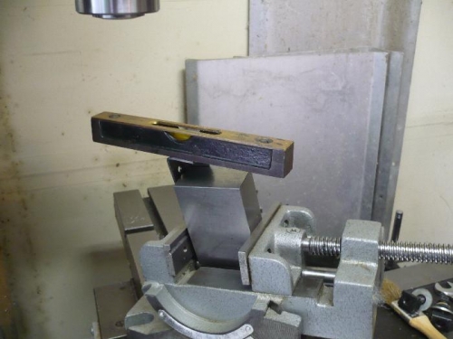

Balanced bracket in angle vice with level in both directons. Didn't really like the position of the transfered hole center so I made the hole central in the tab and cheated the firewall open to the bracket.
