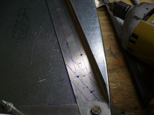

Layout and drill all rivets holes in main firewal
Transfered the L-angleedge layout to the other side on 6b6-3's to get those two holes in the right place first before running the stagger pattern down the 6b6-3's
Have .040 Side braces to do.
Those are the two start holes

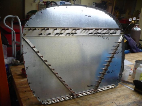

Engine side

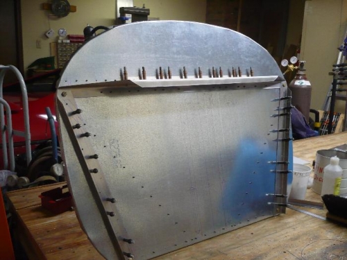

Cabin side
