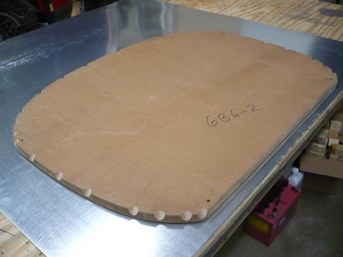

Stopped by a heating and cooling place and bought a 4' x 4' x 26 gage sheet of galvanized steel for the fire wall. They charged me $24.
Layout 18mm line offset from the form.

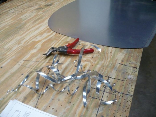

Rough trim with large shears about 3/8 to 1/2 inch away from final trim.

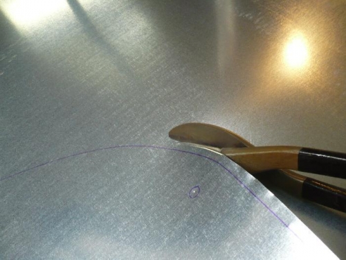

Final trim with the prosnips.
Layed out, cut and deburred 6b6-2 The form has the engine mount holes in it already so those also got transfered to the sheet.
