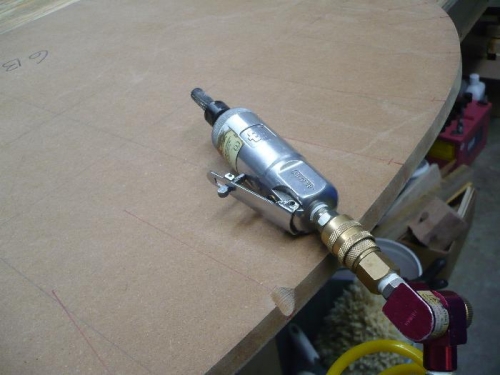

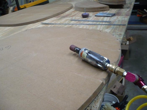

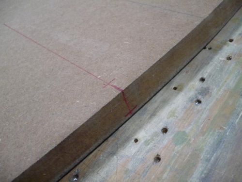

Pulled all the bulkhead forms down and layed out the firewall crimps and used a rough round rasp to cet the material out of the way and to establish the shape and line.
The layout is just a straight line between points and using the roughing tool then a 3/4" dia. sanding drum it goes pretty quick and controlled. Use two hands on the air tool for better control. It actually took longet to lay it out than it took to cut em in.
