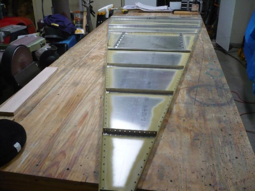

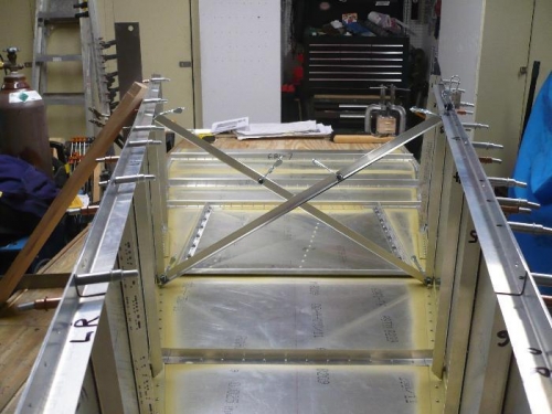

Brought floor in and layed it on the table. Hooked the right side on and supported it with the big carpenters square, hooked the left side and leaned a board against it.
Made an ajustable cross brace from L-angle, used clamps to adjust and squared up both sides.
