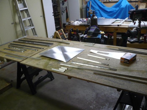

Finished trimmimg lower hinge parts and lower longerons.
Spread part out on table and cleaned them with lacquer thinner.

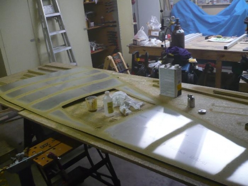

Purchased new detail spray gun at Harbor Freight item munber 92126.
Sprayed all loose parts then let them dry a little. Placed skin on top of parts and sprayed it.

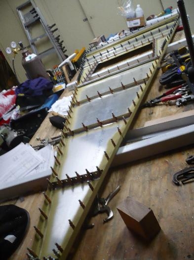

Clecoed it all together and movet it back to the main wok bench.
Ready to rivet.
