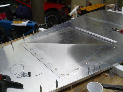

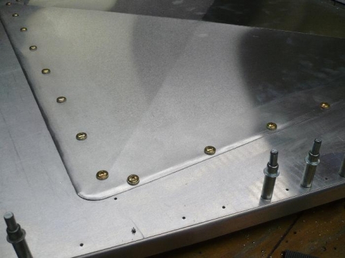

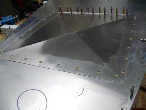

Didn't like the gaps I was seeing between the screws so I made a slight bend around the perimeter of the door over the edge of the bench for the straights, and used pliers for around the corners.
Now I like the way it looks. When the screws get tightened now it even draws the center towards the bottom making it flater.
Don't like gaps
Don't like gaps
Slight flange
Slight flange
That's better
That's better
