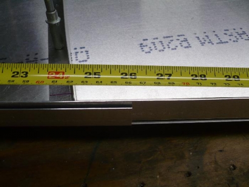

Brief Description:  Rear longerons
Made these parts from what I had, they are short 1220mm rather than 1970mm, so I called Caleb at Zenith and explained wanting to splice towards the back. He said two splices were not a good idea. I called him back and asked about just leaving them overlap 650mm and he said that would be OK. So the top and bottom rear longerons are going to overlap.
Made shim 6-b-2-5
The 650mm overlap
The 650mm overlap
Gonna trim some to miss rivet
