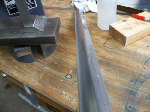

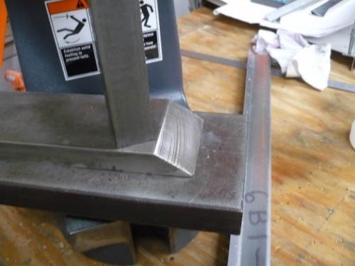

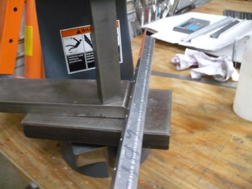

Brief Description:  Smooth out flange on the Z-Angles
Used the 1.5 ton Dake press with the setup below to step through the flange and take the wrinkles out. The base and angled piece are tools I have had forever and come in handy for all kinds of stuff. The Dake is actually a O model whis is 1.5 tons and costs around $400. Sure has come in handy today. See next entry.
