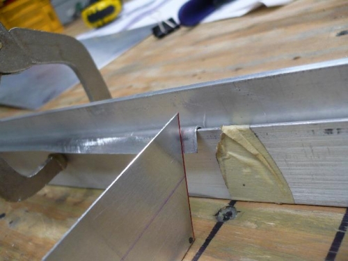

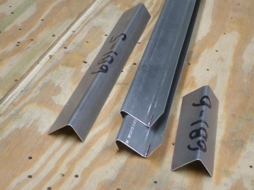

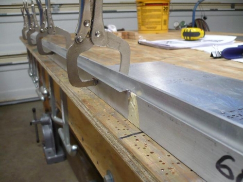

Brief Description:  Formed 5, 6, & 7 details
Used leaf break to bend the 5, 6, & 7 details. The 7 detail need some help getting the bend all the way. Made a template and was able to clamp it between two angles which just happened to be the right size, and hammer the flange down to the correct angle.
Fixture angles
Fixture angles
Checking Template
Checking Template
Completed parts
Completed parts
