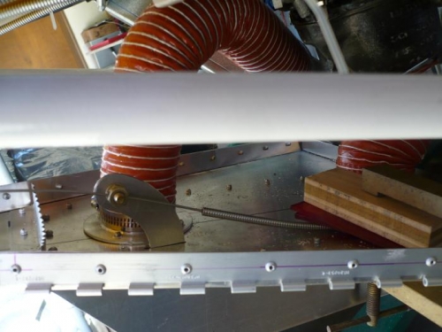

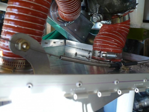

Carb heat cable placement
Modified a 1/4-28 bolt to clamp the cable end and act as a pivot point on the lever. Using jam nuts to hold the cable at the through hole in the bolt.
The test worked so it's only going to take one adel clamp and a couple layers of shrink tube to hold the cable in place.
test idea
Closed
Clamped
