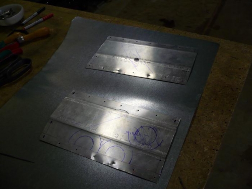

Removed the aluminum heat muff mockup and tightened it up some. Then I flattened it out and used it to layout the galvanized steel one, especially the required clearance dent on the bottom.
Cut and bent up the galvanized steel (same as firewall material) and have templates to remake.
Deburred and riveted the cabin heat valve.
The aluminum gets flattened
