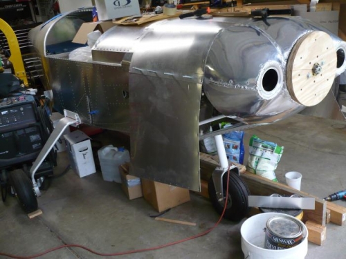

Lower Cowl Panels
Transfered the Dzus hole centers to the upper cowl panel.
Opened the Center holes up for the Dzus fastners and riveted the Dzus springs to the C-Chanel/Lower Cowl Panel. Check fit.
Open Screw holes and hinge rivet holes. Dimpled Screw holes. Drilled for Nutplates.
